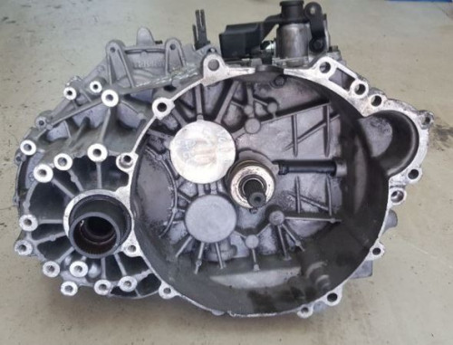

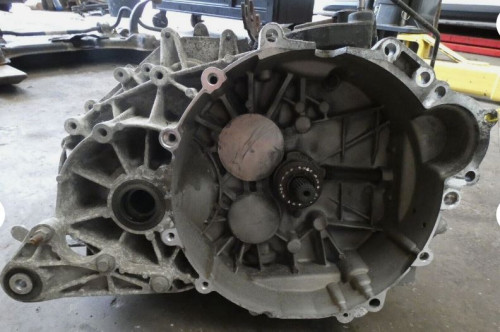

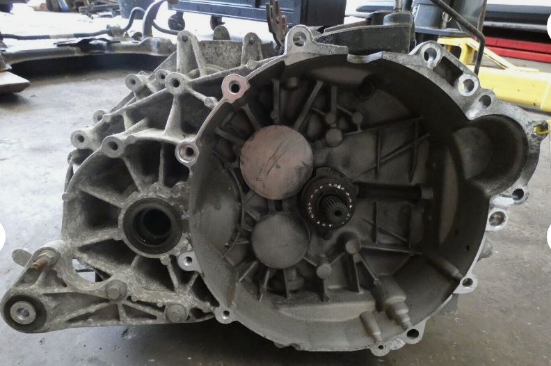

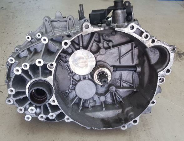

The difference between the FWD and AWD gearboxes lies in the bellhousing and differential, as with AWD you need to be able to bolt a transfer case to it plus take the drive from the gearbox to the transfer case (using a drive collar). You can see the differences in the two pics below. The first is a FWD box and the second and AWD. Note the extra bolt holes in the AWD bellhousing and the larger seal opening to take the drive collar.
XR5 FWD Gearbox
AWD Gearbox

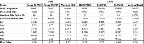

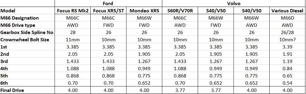

There are three ratio sets - close (RS/XR5/S60R), wide (S40/V50/Mondeo) and long (Diesel Volvo's across all models). The ratios are listed in the table below.
