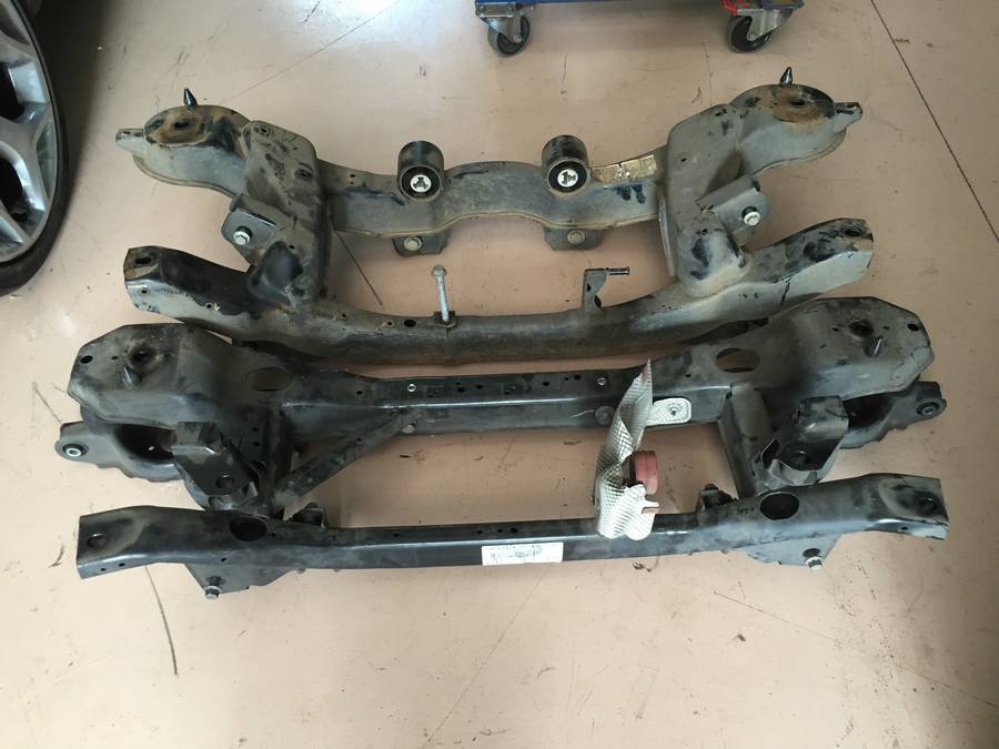

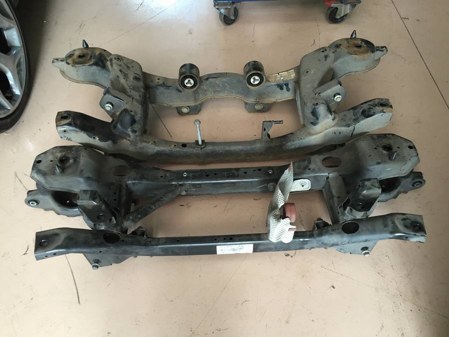

Comparison of rear crossmember - AWD top, XR5 bottom.
Everything will pretty much bolt to this AWD crossmember just the same as your standard crossmember. The only difference is the rear shock absorbers. Because they have to make their way around rear driveshafts they mount differently to an XR5 and are a unique length. For that reason you can't use whatever you have in your XR5 and will need to use the Volvo ones. Apart from standard Volvo units the only other options that I'm aware of are coilovers from either KW or BC Racing.
